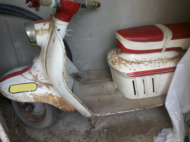

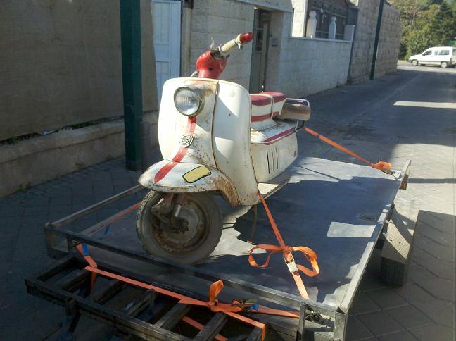

Hello
My name is Roi and today I finished transferring the ownership on a Heinkel 150 (1964) I received last week.
It needs lot's of work (that will probably take me several years to finish) but overall it's in good shape.
I look forward to learning from you here about my Heinkel and if any body have any tips for me on where to start with the restoration I will be happy to learn.
Thank you in advance.

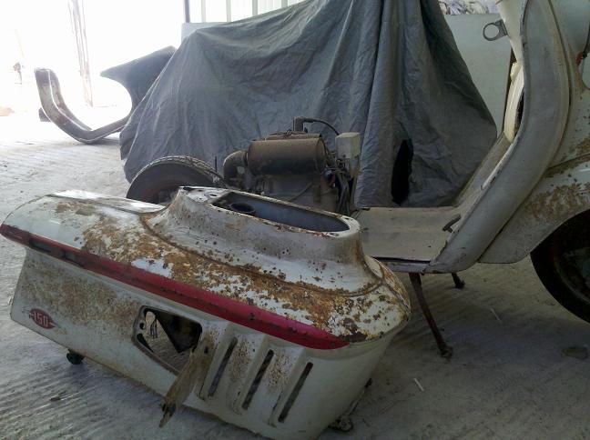

I have started to disassemble the back cover but from some reason it will not come off.
If any body can take me true it step by step it will be very helpful.

Thank you all for the tips and explenations.
As you can see, the back is off. I also checked and found that the engine is NOT seized

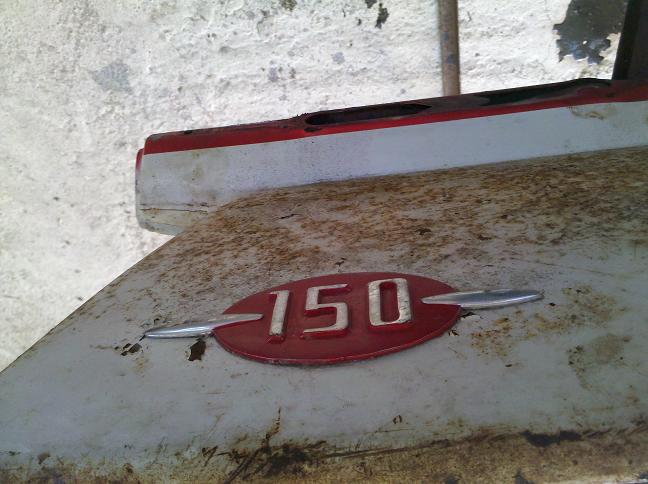

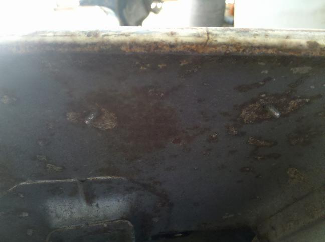

Any body know how to disconnect the "150" emblems from the sides ? from the inside it has two "bent" pins. can I just bend them back or is there a trick to it ?

Heinkel 150
Have a look to your part list
Part 23 a describes the "speed fix"
Remove carefully the "speed fix" from the two pins. There is a high risk to demage the pins. However, I would not spend too much energy into the look and feel of your scooter The most critical part is the engine. Have in mind. Just 7000 of these model have been produced - less than a few hundreds have survived. Therefore parts of the engine are rare. Get the engine running and the rest is just time and money.
BTW: I am curious to learn, how the scooter has made it to Israel. Do you know more?
Andreas
