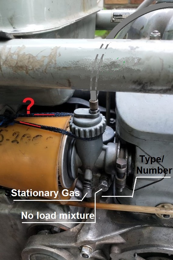

Thank you I found the manuals but I didn't know that I can find extra information on club website. I tried to regulate the carburettor, he's idling really nice, but I am scared the mixture will be to lean. I set the air adjusting screw (regulierschraube) to 1,25 turns and the other one to 4,5 turns. Is that good?
Here is photos of my carburettor.

To adjust the idle mixture, I give the following recommendation:
Warm up the engine properly, operating temperature !
Adjust the stationary throttle so that the engine is still running well at low speeds.
Screw in the air regulation screw until the engine runs unevenly and almost dies (mixture is too fat).
Slowly turn the above screw out again until the engine runs smoothly and the speed
no longer increased ! By further unscrewing this screw changes the smooth running
of the engine not much but the idle mixture becomes too lean and damages the engine !
I always "feel" my way to the border between fat and optimal!
The idle speed is set by means of a adjusting screw.
The throttle pull is adjusted in such a way that about 1mm play is noticeable when pulling up, without the speed
of the engine. The gas slider sits on its adjusting screw and does not "hang" on the train!
viewtopic.php?p=8277#p8277
Du solltest auch nachsehen, ob die richtige Gemisch-Regulierschraube eingedreht ist :
You should also check if the correct mixture regulating screw is screwed in:
viewtopic.php?p=15755#p15755
To ? :

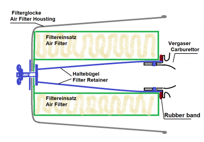

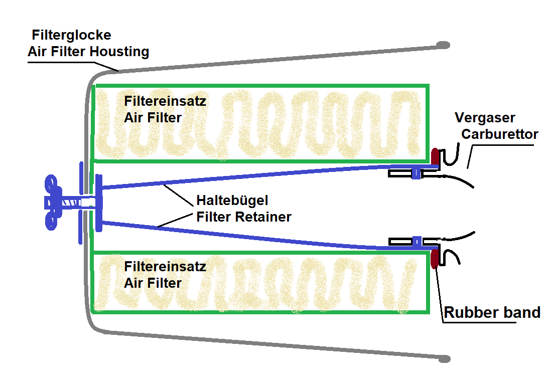

The model of my carburettor is Bing 1/20/51 and the tip of regulating screw have 15 mm.
About air filter. Last owner lost the Filter retainer. That's why I put this rope there, but I must buy or make new filter retainer.

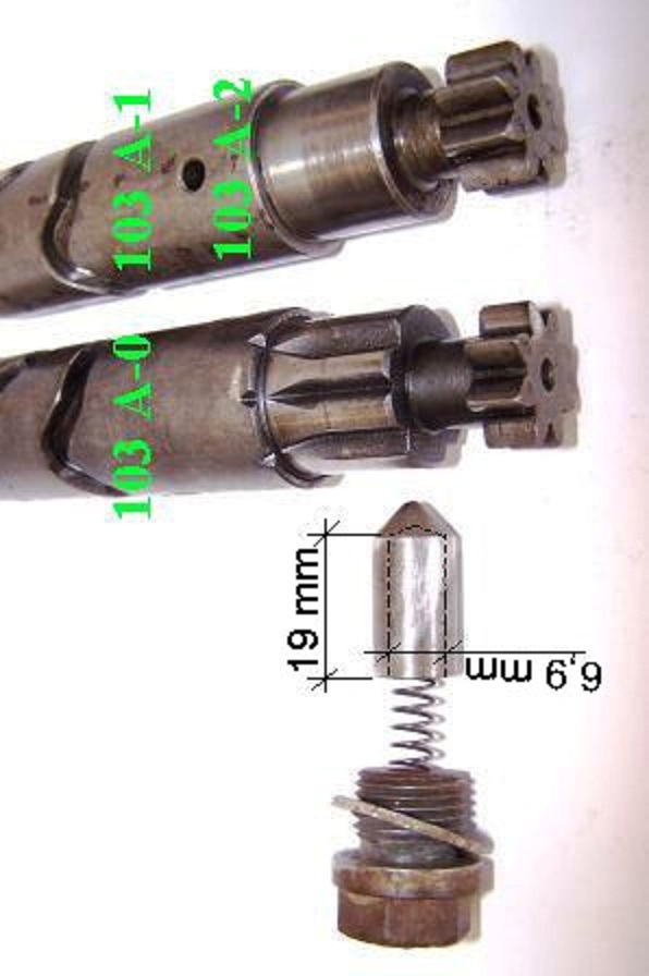

Hi, I was working on my Heinkel and I saw this screw. Now I'm just curious for what is this screw?
Hallo, ich habe an meinem Heinkel gearbeitet und diese Schraube gesehen. Jetzt bin ich nur neugierig, was das für eine Scheiße ist?
Beiträge: 3428
Re: My first Heinkel
Hallo Dueros,

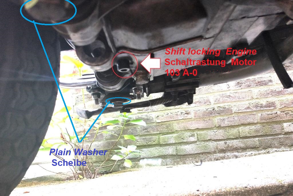

diese Schraube gehört beim 103 A-0 Motor zur Getrieberastung:
this screw belongs to the gearbox locking of the 103 A-0 engine:
Tafel 1 Crankcase, Pict. 19 - 21
Entweder Dein Motor wurde damit nachgerüstet oder es ist ein A-0 Motor eingebaut.
Either your engine has been retrofitted with it or an A-0 engine is installed.
Fehlen an Deinem Motor die großen Scheiben unter den Gummilagern ?
Is your engine missing the large discs under the rubber bearings?
DieZuordnung der Motor-Nummern zu den Typen findest Du hier:
The assignment of the engine numbers to the types can be found here:
https://www.heinkel-club.de/t3/en/ml/ve ... 3-a-0.html
Das ist lustig:
Translation:
That's funny:
Hello, I worked on my Heinkel and saw this screw. Now I'm just curious, what kind of shit is that? :lol:

This change probably is done by Heinkel Service Nederland.
The principles of the A0 have been adopted but thinner pin and bolt, the shift shaft of 103A2 is also provided with slots where the pin falls into.

I checked the engine number and it started with numbers 584. That means it is A2.
Ich überprüfte die Motornummer und es begann mit den Nummern 584. Das heißt, es ist A2.
Heinkelkrematorium hat geschrieben: 14.08.2021, 20:11 This change probably is done by Heinkel Service Nederland.
Yeah, probably that's why my engine have this screw. He was few times repaired by Heinkel Service Netherlands.
Ja, wahrscheinlich hat mein Motor deshalb diese Schraube. Er wurde einige Male von Heinkel Service Niederlande repariert.
heinkel-bernd hat geschrieben: 14.08.2021, 17:05 Fehlen an Deinem Motor die großen Scheiben unter den Gummilagern ?
Thank you. That is my mistake. I put the large discs washer on wrong side :oops: .
