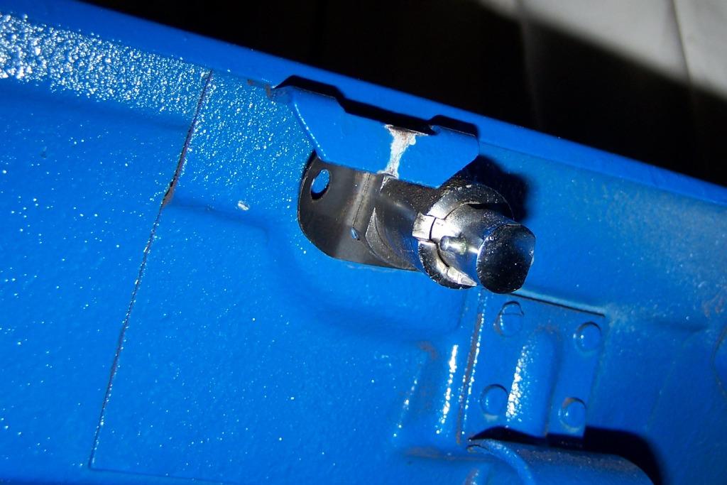

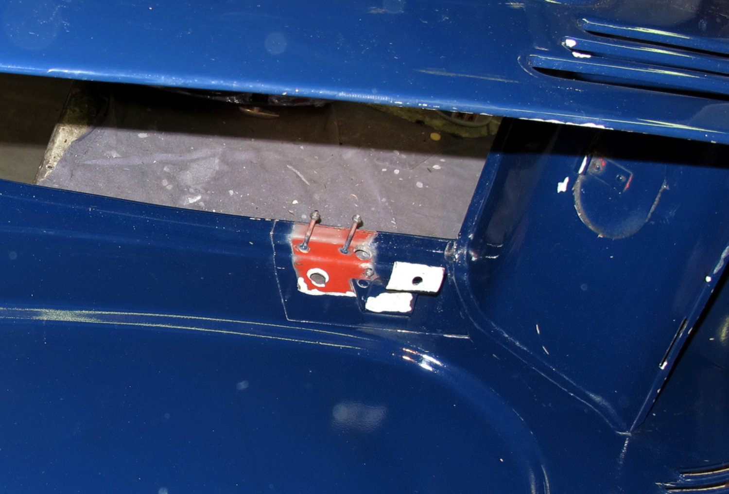

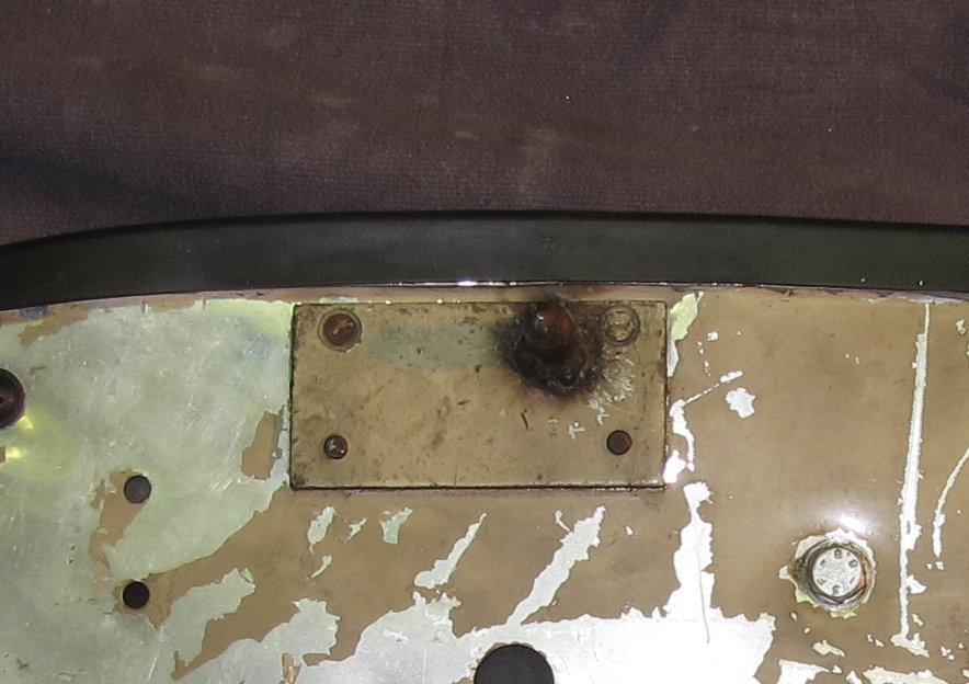

Now let's get to your problem. I own an A1 "only" so I can't help you with pictures for the A2. But here is how it looks for an A1:
1. Rear body cowling without locking mechanism (seen from the underside)
2. Rear body cowling with mounted locking mechanism (seen from inside the cowling)
3. Locking pin at underside of the seat (top view)
This pin enters the hole in the locking mechanism when the seat bench is closed.
I hope this helps at least a little bit.

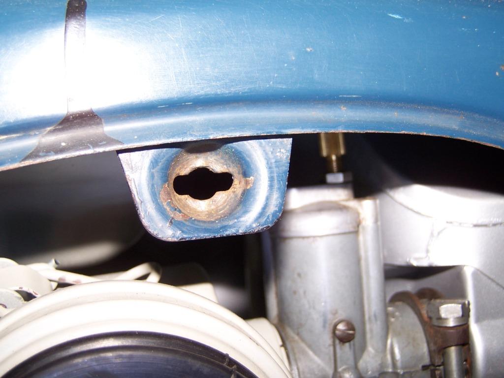

Here are some picture to illustrate my question.
I bought the parts 26, 26a,b,c,d on page Karosserie on 103A2.
The lock of the flat can’t Iock in the hole in the karosserie, something should miss in the hole and I don’t find in the part list.
Below sequence of picture zooming in the hole where something miss

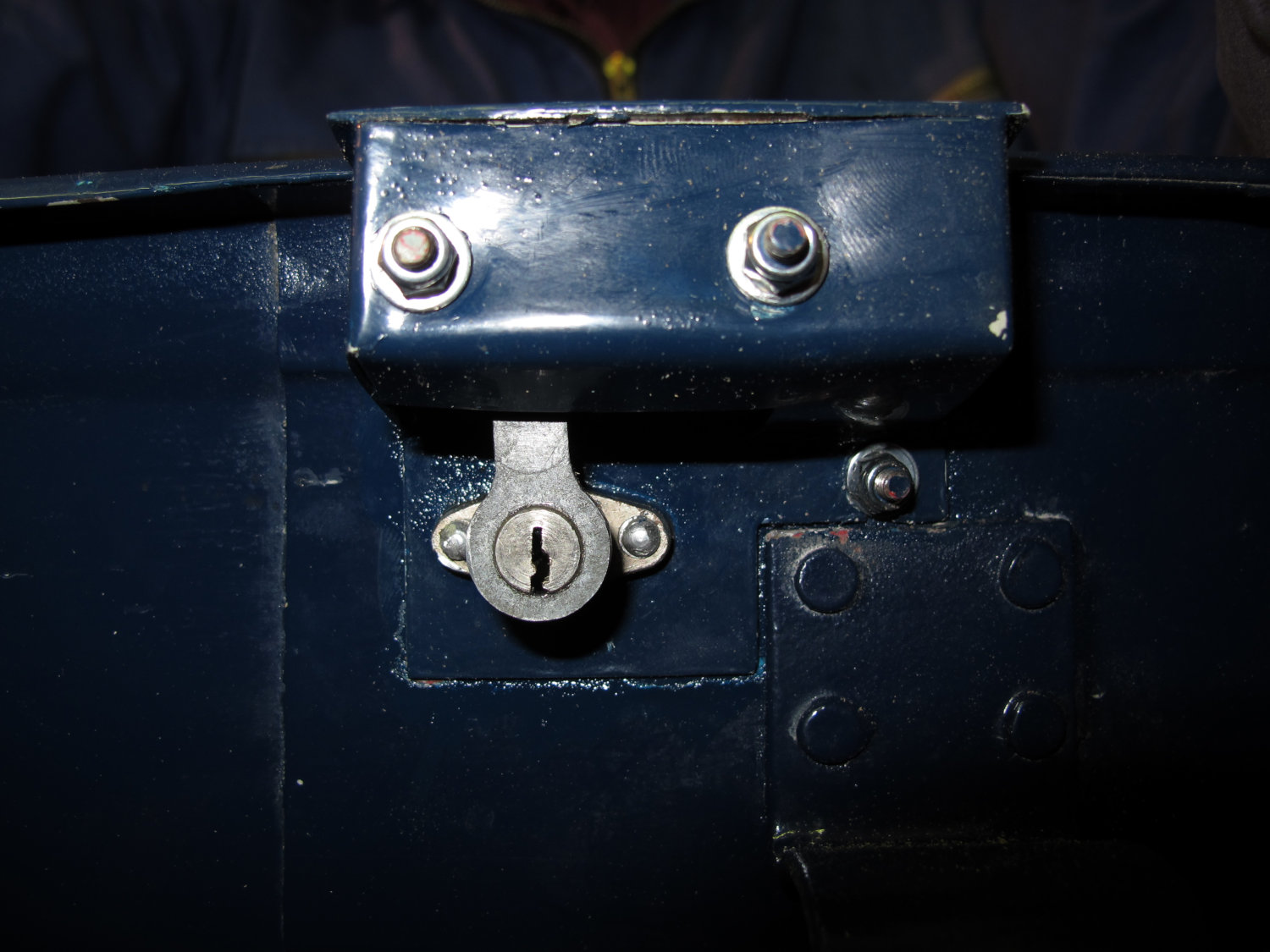

Hier jetzt die richtigen Fotos vom Deckelverschluss: Dieses Verschlussteil ist am Krosserieblech nur viermal angepunktet, löst sich oft vom Blech
und geht verloren
Da man im Werk davon ausging, dass es dauerhaft hält, wurde und wird es auch nicht als Ersatzteil
angeboten (Vermute ich mal)
Und hier der vergleichbare Verschluss der Vergaserklappe: P.S.: Mein richtiger Vorname ist Bernhard und meine Urahnen stammen auch aus Frankreich (Hugenotten)

Thanks Bernd,
I understand now that à welded part is missing!
I will try to find another solution.

Re: Flap lock (case under seat)
Hi Bernard
(and Hi Bernd),
I think there is no further need for a translation - you got the essentials of Bernd's post.
Just a few things for clarification:
Bernd writes under picture 2 "this locking part is only spot welded four times to the body plate; it often detaches itself from the plate and gets lost
I assume that the manufacturer thought it would last a long time and that could be the reason why it is not available as a spare part.
And here the comparable fastening cap of the carburetor flap" (follows picture 3)
My closing thougt: If you are a good metal worker you could try to manufacture such a locking part from a piece of sheet metal (using the piece from the carburator flap as a "template". Fix it to the rear cowling with four spot rivets and you should be good to go.
Kind regards,
Bernd(St)

Many thanks both Bernd
Your pictures and explanations helps really, I understand now what to do.
I will make a piece from sheet or from a large flat washer and screw or rivet it in the karrosserie.
Thanks again and most probably I will ask other questions (if I don’t find myself on the forum) about other topics, carbs and tachometer gear on the wheel
