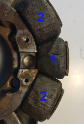

Dear Dueros,
indeed 0.4 Ohm between DF and D+ is not as good. A perfect stator has a resistance of approximately 4 Ohm. I think you have some coils in your stator with a turn-to-turn fault. Six of the twelve stator coils are field coils for the alternator. I'm pretty sure, some of them are broken. And the mess is: You need some new ones, but it is not possible to buy them anymore - that's the inconvenient truth at the moment. May be to your information and to your interest: The other six stator coils are coils for the electric starter. The two kinds of coils are easy to distinguish, look to the figure, the shapes are different. So, if your engine starts correctly - here are the good news: Your starter coils and your rotor are working well. May be you have a look to the carbon brushes and the commutator - everything alright? However, your Dynamo have to fixed and that's possible, so please don't throw in the towel. You can send the dynamo to the Heinkel Club and you get it refurbished back. The Club has some old coils in good condition and replace thereby your broken one. This operation is not as cheap, but I think, that's the only way you have. So, if you've any more questions don't hesitate and leave another post here.
Best regards, volker from Wiesbaden
Figure: 1 field coil , 2 starter coil

Hi,
Thanks for information. Yes, starter work good, and I check carbon brushes. They are looking for new ones.
I just bought a second dynastarter, because this was a cheaper option, but I have problem with it also. This Dynastarter should be ok. Seller said that he took it off from other broken Heinkel long time ago. I checked the resistance and I got 5.2 (Ohm). Carbon brushes are perfect. But after installation in my engine I'm only getting 1.5 V. I don't understand why and what is wrong now. Can somebody help me?
