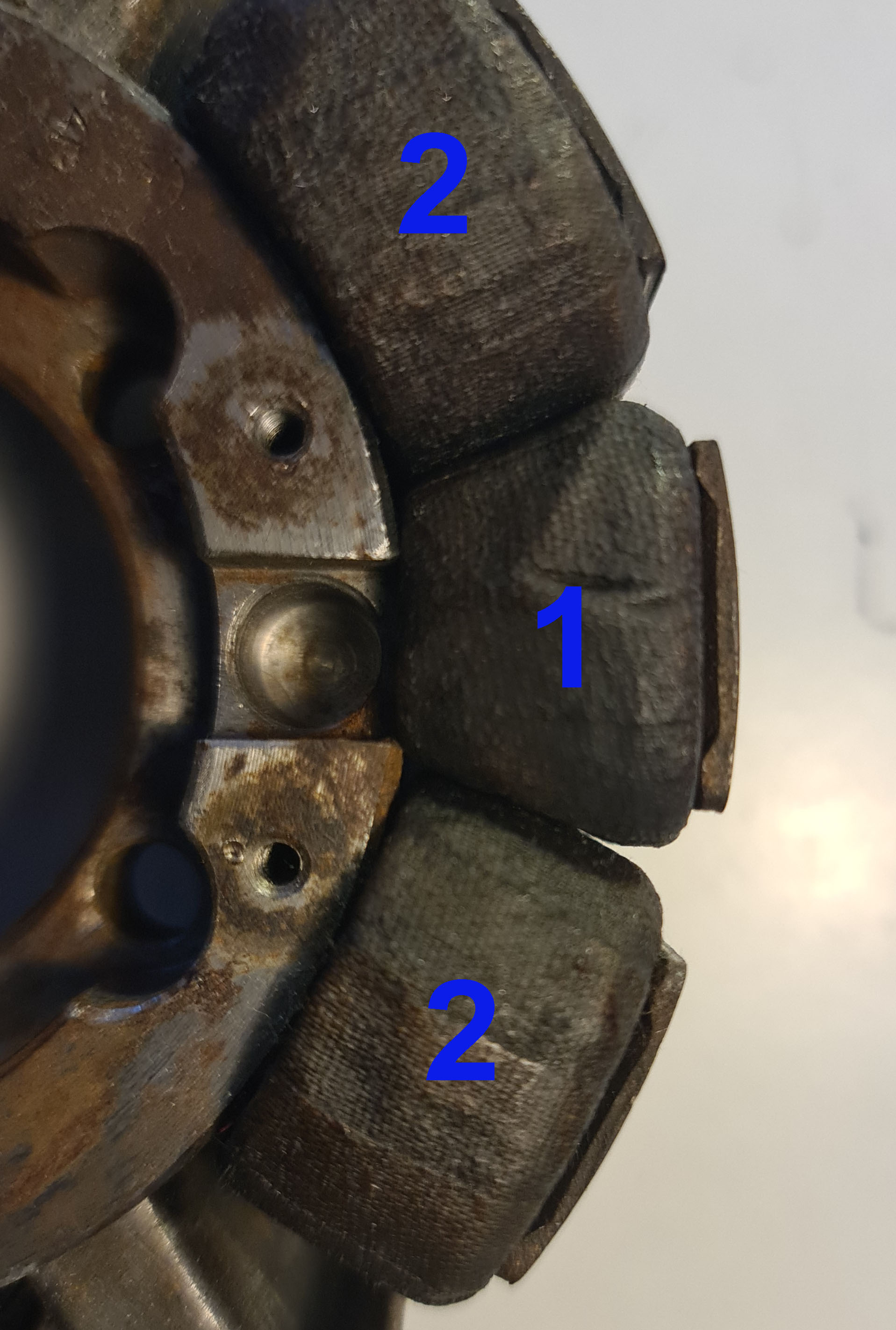

Hi,
I have problem with Bosh dynamo in Heinkel 103 A2. I was getting max 10V from it and I decided to take it off. I checked it and get only 0,4 Ohms between DF and D/+61. I think some coils must be broken, but i will ask here before I decide to buy new one. Should I check something else maybe there is other reason why i get only 0,4 Ohms?
Ich habe Probleme mit Bosh dynamo in Heinkel 103 A2. Ich bekam max 10V davon und ich entschied mich, es abzunehmen. Ich überprüfte es und bekam nur 0,4 Ohm zwischen DF und D+/61. Ich denke, einige Spulen müssen gebrochen werden, aber ich werde hier fragen, bevor ich beschließe, eine neue zu kaufen. Sollte ich etwas anderes überprüfen, gibt es vielleicht einen anderen Grund, warum ich nur 0,4 Ohm bekomme?

Re: Dynamo / Lichtmaschine
Dear Dueros,
indeed 0.4 Ohm between DF and D+ is not as good. A perfect stator has a resistance of approximately 4 Ohm. I think you have some coils in your stator with a turn-to-turn fault. Six of the twelve stator coils are field coils for the alternator. I'm pretty sure, some of them are broken. And the mess is: You need some new ones, but it is not possible to buy them anymore - that's the inconvenient truth at the moment. May be to your information and to your interest: The other six stator coils are coils for the electric starter. The two kinds of coils are easy to distinguish, look to the figure, the shapes are different. So, if your engine starts correctly - here are the good news: Your starter coils and your rotor are working well. May be you have a look to the carbon brushes and the commutator - everything alright? However, your Dynamo have to fixed and that's possible, so please don't throw in the towel. You can send the dynamo to the Heinkel Club and you get it refurbished back. The Club has some old coils in good condition and replace thereby your broken one. This operation is not as cheap, but I think, that's the only way you have. So, if you've any more questions don't hesitate and leave another post here.
Best regards, volker from Wiesbaden

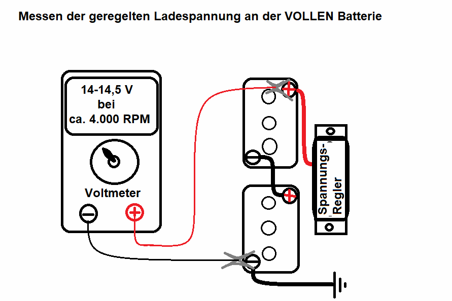

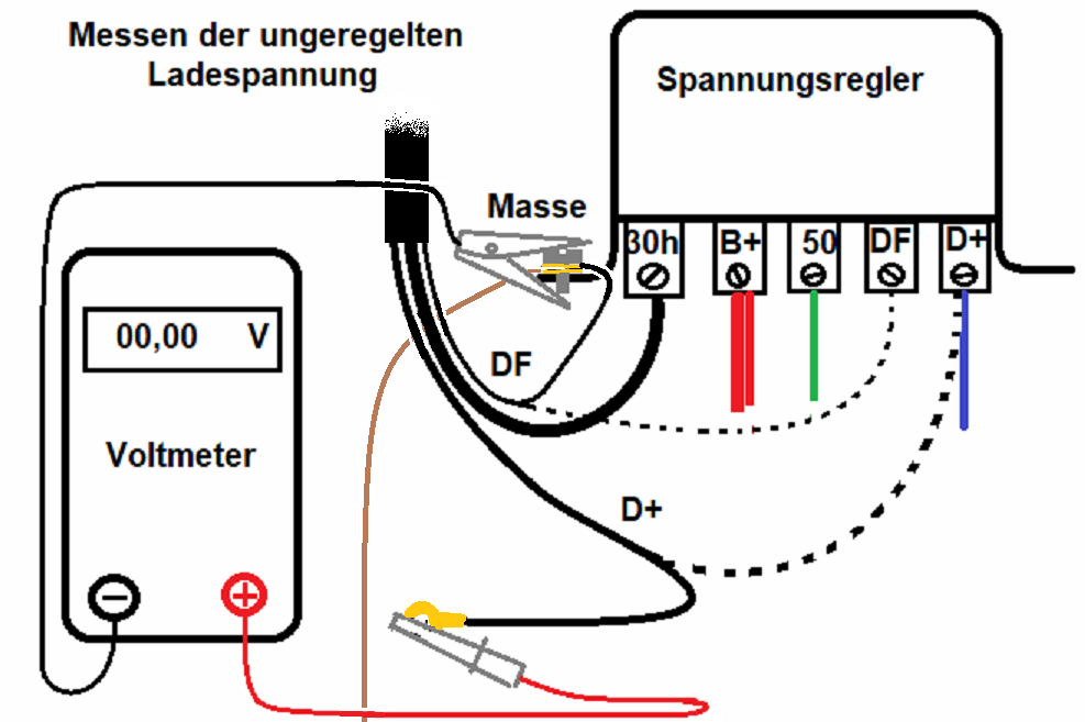

Hallo dueros,
first you should check the unregulated charging voltage of the alternator !
From medium speed, the voltmeter should already show about 60 to 70 V
If that's OK, it will be due to the voltage regulator
zuerst solltest Du die ungeregelte Ladespannung der Lichtmaschine prüfen !
Ab mittlerer Drehzahl sollte das Voltmeter schon ca. 60 bis 70 V anzeigen
Wenn das o.k. ist, wird es am Spannungsregler liegen
I wrote about unregulated voltage
. I got 1,5V on idle max 2V.
Ich schrieb über ungeregelte Spannung. Ich habe 1,5V im Leerlauf Max 2V.
- Beiträge: 3428
But I couldn't read that about the "new" alternator anywhere anddueros hat geschrieben: 11.09.2021, 21:05 I wrote about unregulated voltage. I got 1,5V on idle max 2V.
unregulated Voltage of max. 2 V I can not believe
Dismantling the rotor
contact with the motor housing !!!
Das konnte ich über die "neue" Lichtmaschine aber nirgendwo lesen und
ungeregelte Spannung von max. 2 V kann ich nicht glauben
Rotor demontieren
Kontakt zum Motorgehäuse haben !!!
Ok, I fixed this dynamo. Just a good clean was enough. I think somebody in the past put new carbon brushes and spray everything with electric spray. That caused low resistance between brushes and ground. Now it works perfect 16V (unregulated) on low idle.
I have one more Question about voltage regulator. I think my is dead or almost dead. I can try to fix it, but I know that this type of regulators are not the best. I was thinking about something more modern, but I don't know what type/model can I use. Has somebody experience about changing the regulator? I saw on Heinkel shop option to buy one, but no way I'm going to pay €190 for a simple regulator.
Ok, ich habe diesen Dynamo repariert. Nur eine gute Sauberkeit war genug. Ich glaube, jemand hat in der Vergangenheit neue Kohlebürsten gesetzt und alles mit elektrischem Spray besprüht. Das verursachte geringen Widerstand zwischen Bürsten und Boden. Jetzt funktioniert es perfekt 16V (ungeregelt) bei niedrigem Leerlauf.
Ich habe noch eine Frage zum Spannungsregler. Ich glaube, mein ist tot oder fast tot. Ich kann versuchen, es zu beheben, aber ich weiß, dass diese Art von Regulierungsbehörden nicht die besten sind. Ich habe über etwas Moderneres nachgedacht, aber ich weiß nicht, welchen Typ/Modell ich verwenden kann. Hat jemand Erfahrung mit dem Wechsel der Regulierungsbehörde? Ich sah auf Heinkel Shop Option, eine zu kaufen, aber auf keinen Fall werde ich 190 € für einen einfachen Regler zahlen.
- Beiträge: 3428
Servus dueros,
warum prüfst Du nicht mit höherer Motor- Drehzahl, so wie vorgeschlagen ??
why don't you test with higher engine speed, as suggested ??
Average engine speed is about 3,000 RPM !
Erst wenn das gut ist, kannst Du die ungeregelte Spannung am Spannungsregler messen !!
Batterie muss voll geladen sein !
Only when this is good, you can measure the unregulated voltage on the voltage regulator !
Battery must be fully charged !
Mittlere Motor-Drehzahl ist ca. 3.000 RPM !first you should check the unregulated charging voltage of the alternator !
