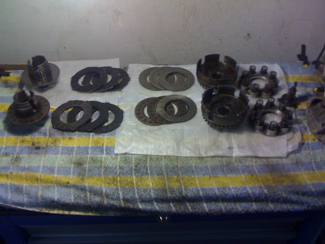

Hello Members!
I spent quite a lot hours in garage and got some results.
Rims were sandblasted, now they went for making them straight. After that I will decide to chrome or to paint them.
I also received new clutch basket (my was welded).
I started to polish details, here I got some results :
I also took handlebar into pieces, cleaned everything, now waiting for sodablasting to make everything shine.
About body panels:
I want to take off whole paint to raw metal, first I want to use paint-remover (waiting for mask to prevent inhalation of all toxic gases), then it will go for sandblasting to remove rust, then for welding (places where rust ate metal), then for zinc-plating and at the end for painting.
Still looking for gearbox, rear fender and new piston
