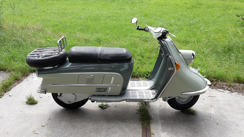

this is it

Hi Ron,
it looks really great - the combination of 2 different shades of the same colour, as well in the front as well as on the rear part (which is available only for the 103 A2) is very nice.
I have 2 103 A1, you can see one of them in the picture gallery, those pictures are from 2011:
http://www.heinkel-club.de/t3/m-l/mehr- ... 7c2714afcf
I wish you a lot of fun with the scooter - and I'm sure, as soon as the shifting problem will be resolved, you'll have fun!
Carsten
P.S. you might want to turn around the luggage rack on the spare wheel:

Hi Carsten.nice scooter. Colors are beautiful. Really better than the yellow.
Greetz ron
Btw you are right a bout the rack i know. Did it so the passenger has something to hold on to
