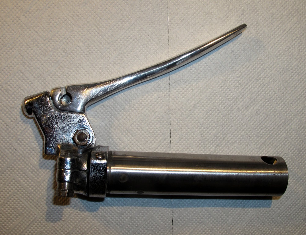

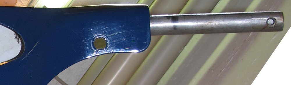

The trick is to find the hole, where the screw is. This screw holds the cap in place. Here are two photos showing a dismantled throttle and handlebar that should give you the right idea (these are from a 103-A1, but it should be basically the same with an A2):
Throttle (viewed upside down!)
Handlebar w/o throttle
If you press the rubber grip with your thumb you can feel this hole. If you are (very) lucky (and if the rubber grip is not too old yet) you can roll the grip back, so that you can reach the screw without destroying the rubber grip. But better get used to the idea that you will ruin the grip with this action (old rubber will split 8 times out of 10...) :( But that's no problem - new rubber grips are available from Heinkel Club's Online Shop. Available in gray and black for only 5 €.
It's best to make a view photos while you are dismantling the throttle - this will help you, when you are reassembling it again.
I wish you a successful repair!
